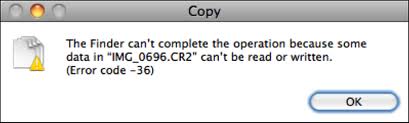

Recently, we encountered a data recovery project where an end user went to a box store with their entire computer because they could not open a particular file. From what we were made to understand, several team members from the box store, including managers, tried to copy, repair and recover the contents of this file without success. After almost a week, they finally gave up.
Fortunately, the client was referred to Recovery Force from an acquaintance. After an initial phone call, we suggested that the symptoms sounded like there were bad sectors in the middle of file. Once the client got the drive to us, we were quickly able to confirm that the drive had bad sectors in the middle of the file. After some persistence by our team, we were able to read all but one sector from the 19GB file and successfully recovery pretty much everything they needed.
