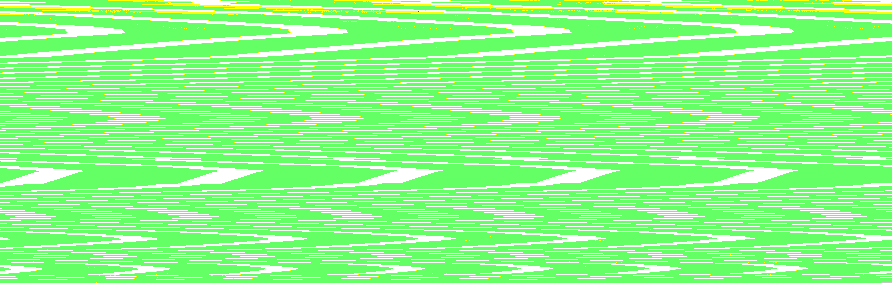

The graphic above is a visual representation of the sectors cloned on a data recovery project, after the heads have been changed. The drive has 4 read/write heads, of which one is not reading at all. With the original heads, all heads had some read errors, with the fourth head not reading at all. After the head change, three heads read 99% while the fourth head still does not read. In this case, the drive fully detects and reads, but will show CRC errors when attempting to read any sectors associated with the fourth head.
