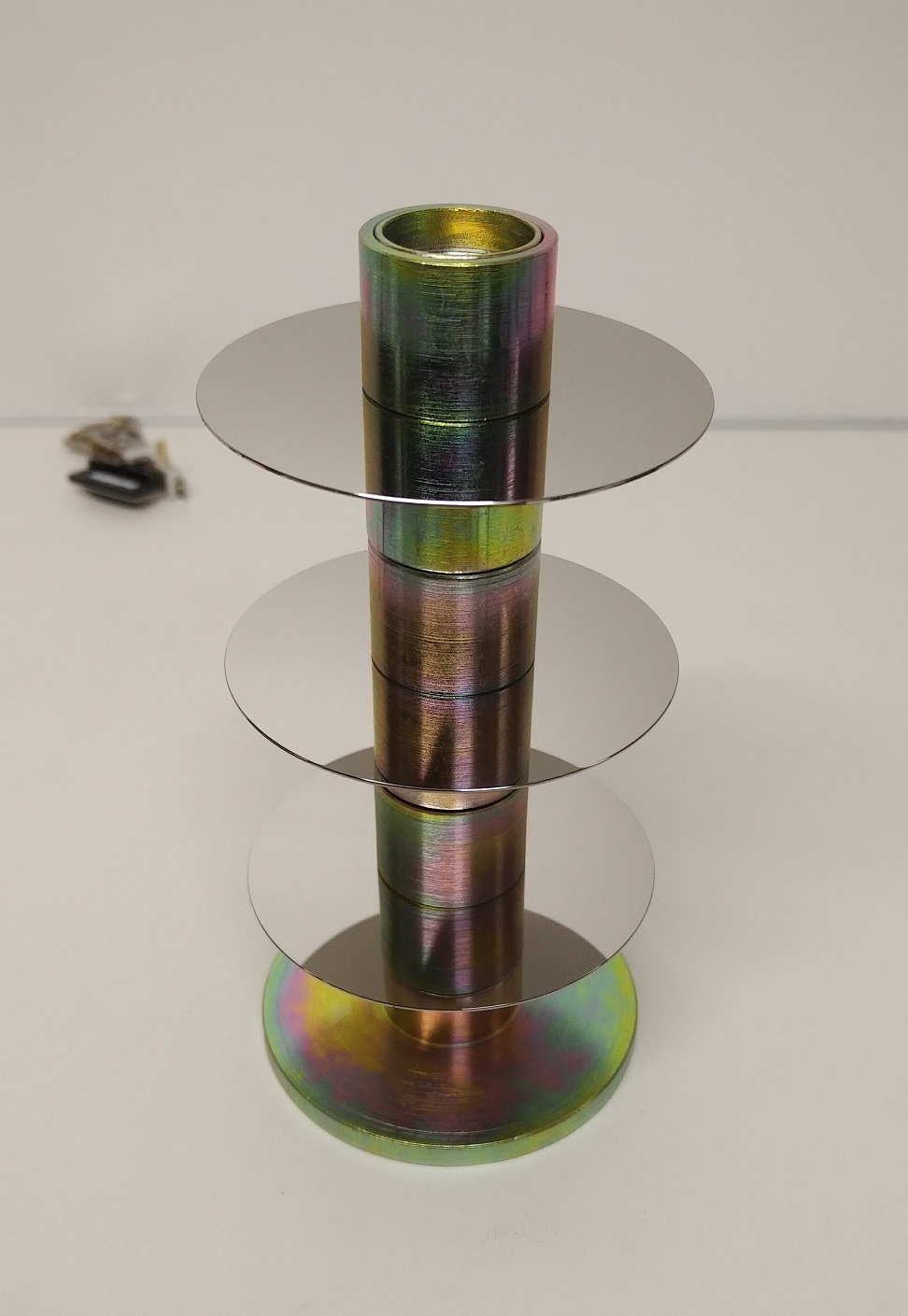

Here is a photo of platters in my new platter stand.

Hi Luke,
what's the need for this platter stand when you deal with multi platter hdd?
If you have multi platter drive, you will end with misaligned platters if you take out then one by one.
Re: Platter Stand
I'm looking into this further. Based on the comments of others and the theory that servo data is spread throughout the surface on most new model drives, one should be able to transfer platters individually. That said, I haven't had time to play much, but the tests that I have tried, thus far, have failed.
