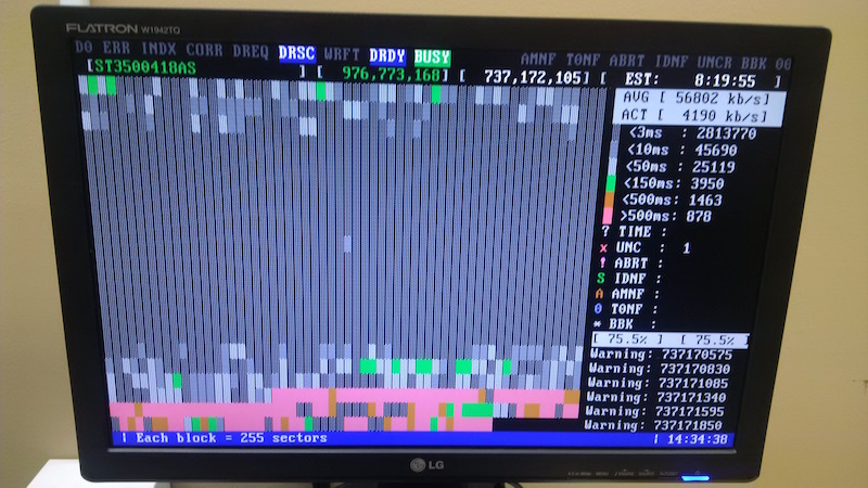

The other day, we had a drive that was failing MHDD testing. For the fun of it, we ran SpinRite on the drive to see how it would do. It ran for a day and when it completed, it reported the drive as healthy. We re-ran MHDD and, as you can see, the drive isn't quite as healthy as SpinRite reported.
After SpinRite Passed.jpg (151.14 KiB) Viewed 168098 times
Nothing quite like SpinRite to mask symptoms, tell you all it well, and give a false sense of security.
Yet the guys who love this program will tell you you're wrong about it, even after they kill someone's drive using it.
Yeah...seems like people will believe it works just because it says it will, even though the evidence shows that it is snake oil.

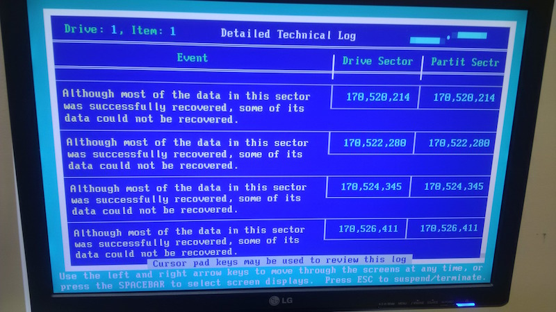

Here is another scary screenshot from SpinRite. What happens when each of those partially recovered sectors are from a critical database file. After the sector has be remapped (partially recovered), there is no way to go back and get anything that was lost. This is called data loss, not recovery.
When a data recovery professional recovers your files and encounters bad sectors, we don't alter them...we do everything we can to get that sector to read and copy to another drive. If we need to, we can get the same partial data that SpinRite gets, but the difference is, if the data in the sector is critical, we can keep going back in hopes to get a better result.
