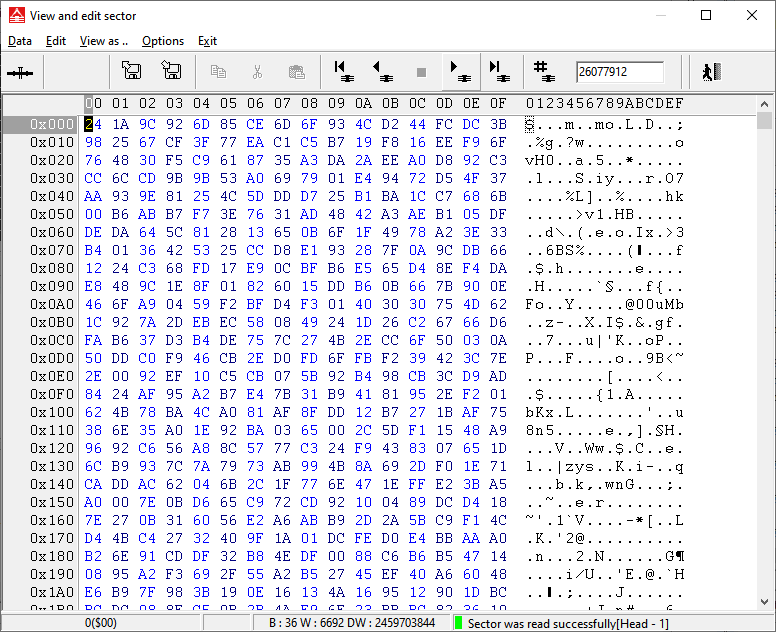

Patient Drive - ST1000LM035, 1RK172-036, WL1..., SBK3, 2 heads
Head 1 is the offender

I'm also having the same issue with this drive. One head reads fine (files are ok), but head 1 just trow trash out even with all sectors green...
A head swap will be done and I will post the feedback here!

Just to be clear, do these bogus sectors occur in groups of 8?

Basically, what is happening is that if the drive timeout is long enough, it sends back one of the two patterns for bad sectors, rather than reporting them as bad. I have found that if you drop the timeout down to 100ms, it will get reported as unreadable.

No, the data in the original sector is theoretically there and can frequently be recovered with multiple reads or donor heads. The pattern we see is only given if the timeout is long fairly long...if you set it to 100ms, it will likely report an error, rather than provide garbage.
In PC3000, you can manually setup a map that will populate based on sector contents. MRT just added it to their default map, so no configuration is needed.
