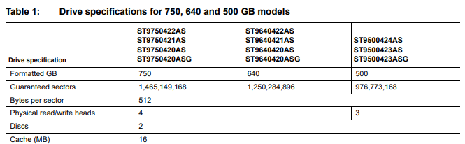

What would be an alternative explanation? AFAICT, in all the "partial" cases the last sector is recovered but not 0 - 6. Is it merely coincidence?
Drive specifications...
Screenshot 2023-11-15 035401.png (35.38 KiB) Viewed 95358 times

512b sectors are 'emulated', right? It's basically a firmware thing that reads 4096 bytes, ECC checks/corrects that and delivers the 512 bytes the host asked for. Even if the drive did ECC every 512 byte chunk then I still don't see how accidentally first 7 chunks all go bankrupt and the 8th does not, in multiple 4K sectors. Makes no sense to me ..
Okay, say 4096 sector with 100 ECC bytes. If I am not mistaken, default ECC bytes for .5K sector is 50. If ECC is done per .5K bytes there's hardly room for any ECC bytes, 100 / 8. No I can not see how .5K sector size emulation is anything other than purely a controller/firmware thing.
