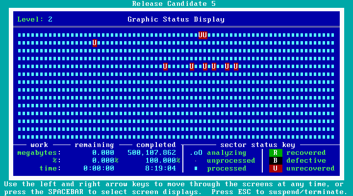

Test #1: I compared SpinRite 6.1 vs RapidSpar Disk Imager...
1. RapidSpar Disk Imager on Balanced Mode cloned the whole drive with just 81 sectors not recoverable.
2. SpinRite 6.1 on Level 2 scanned the whole drive with just 81 sectors not recoverable.
SpinRite stresses the drive for 5 whole minutes while trying hundreds of reads hoping to get data samples. Compared to professional disk imagers that allow much more control over the drive. :o

Ran a 2nd scan on level 2 again but using "dynastat 0" this time...
Where did all the bad sectors go? :o
I cloned the same drive again with the RapidSpar Disk Imager. The previous 81 unreadable blocks have gone, it's now zero, so somethings happened, hmm interesting.
I can only assume that had this been a real Data Recovery case, 81 blocks of data are now gone, this clearly is not a real Data Recovery tool, but is still being marketed as one, and people are still using it, and losing data.
