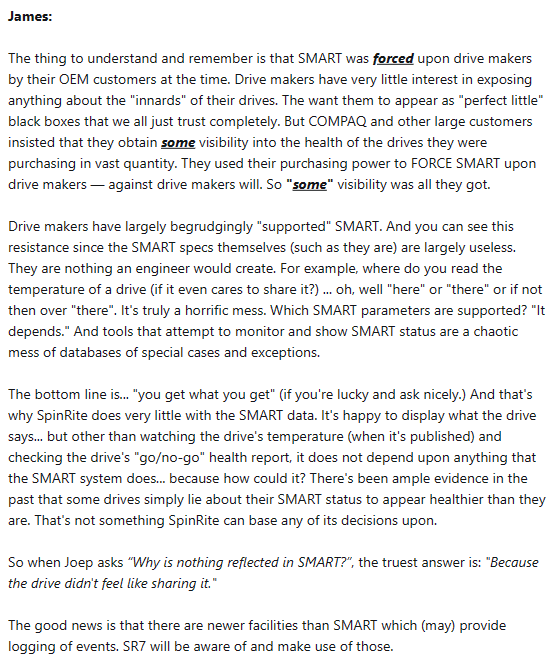

What if SMART just doesn't feel like sharing much on this drive?
Maybe the answer is to stop trusting SMART.
Screenshot 2023-11-15 164841.png (68.54 KiB) Viewed 42405 times

CrazyTeeka wrote: Wed Nov 15, 2023 4:13 pm What if SMART just doesn't feel like sharing much on this drive?
Yes, that's a typical answer from Steve G, half way between I don't know and a conspiracy theory. It's bullshit, and in my experience pending and reallocated are usually accurate regardless the drive brand.
He also contradicts himself, when SR6 was introduced he sort of promised SR would make SMART data useful (also mixed with some vague claims of drives hiding important stuff), reality is that he gets half of the SMART stats wrong. For example, SR hasn't got a clue about SMART stats as reported by Seagate drives.
When I pushed him for an answer how het arrived at this theory: ..
Writing to NAND flash memory requires the generation of high voltage, but reading requires low voltage. Before any NAND chip can write data into NAND flash memory it must internally generate a high voltage. This uses a “voltage pump” which takes time to charge up, and lower-end solid state storage does this much more slowly. Then, before reading, that high voltage must be dumped.
.. he basically brushed it off by telling me "experience". It's a load of mumbo jumbo and I explained him why. 9 out 10 times when he talks about NAND based drives it reveals a total LACK of experience and he's making stuff up as he goes ..
